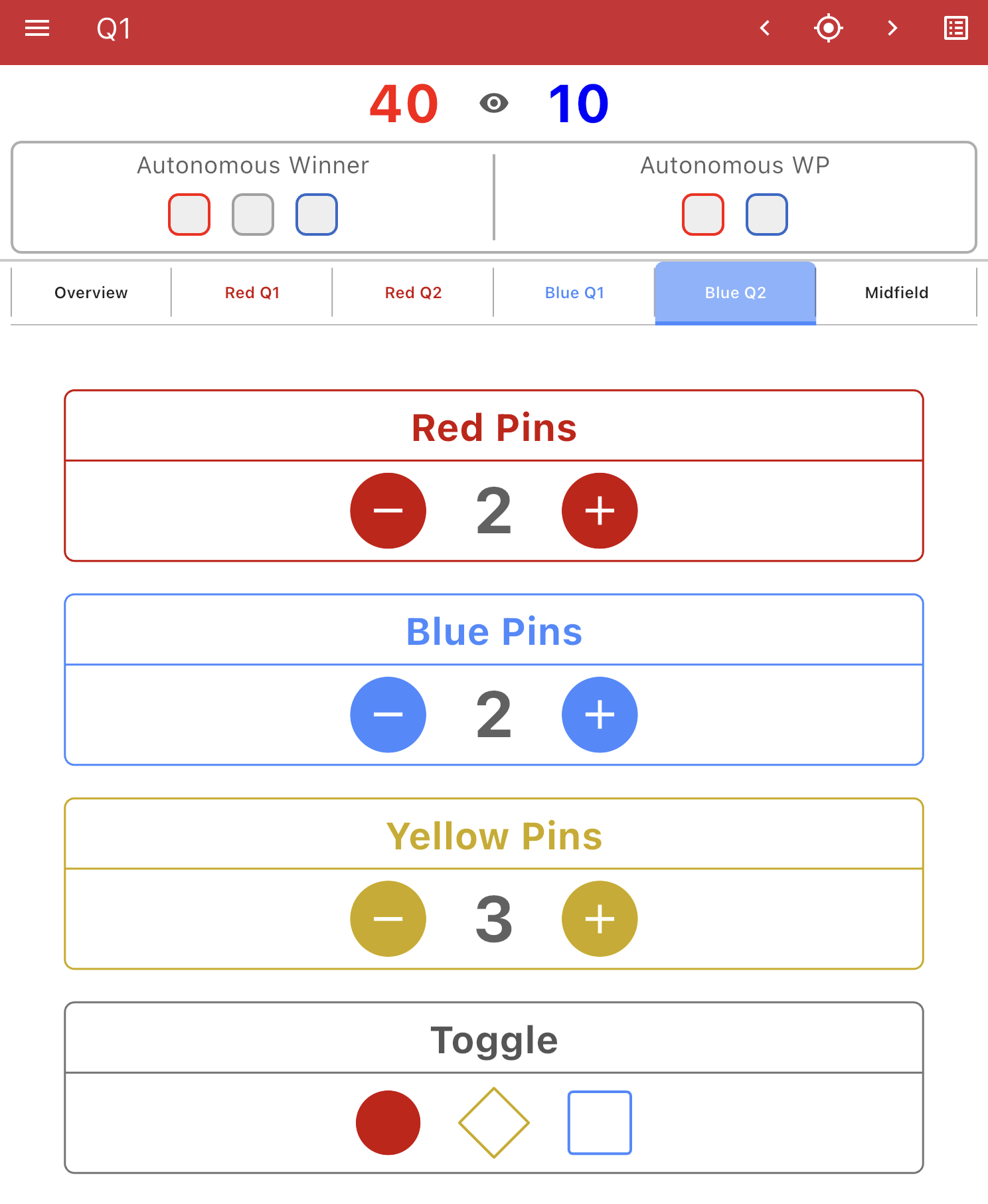

Quadrant Example
In this example, you are evaluating Blue Quadrant 2 at the end of the match. Remember that a Quadrant is one of four designated triangular areas of the Field. Each Quadrant contains two Goals and one Toggle. In Blue Quadrant 2, the Blue Goal is on the right.
Scenario
  • The Neutral Goal has three visible Pins – 2 Red and 1 Blue.
  • The Blue Alliance Goal has four visible Pins – 3 Yellow and 1 Blue.
  • The Toggle for this Quadrant is set to Red.
TM Mobile scoring app showing the Blue Q2 tab with a score at the top reading 40 Red to 10 Blue. The Pin counts are set to 2 Red, 2 Blue, and 3 Yellow and the Toggle is set to red.
The Field quadrant is shown with the scenario described
Referee Takeaway
Toggles are a great way to gauge which alliance has more points in a Quadrant. "In this example, consider what would happen if the Toggle color changed:
  • Yellow: the score would be tied at 10.
  • Blue: the score would be 40 for the Blue Alliance and 10 for the Red Alliance.
Always check Toggle state before assigning points for Yellow Pins. In Override, ownership can create large point swings even when the stack is located in an alliance-colored goal.

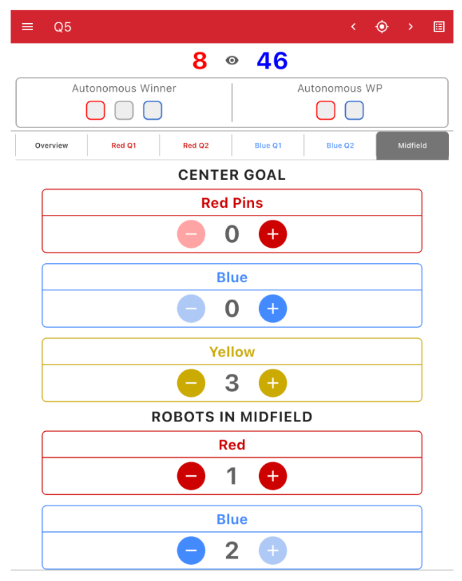

Midfield Example
In this example, you are evaluating the Midfield at the end of the match. Remember that the Midfield is the square area at the center of the field created by the tape lines.
Scenario
  • The Neutral Goal has three visible Yellow Pins.
  • Three robots are in the Midfield – 1 Red and 2 Blue.
The TM Mobile App on the Midfield scoring screen, with a total score at the top of Red 8 to Blue 46. The Yellow Pin count is set to 3 and the Robots in the Midfield counters are set to Red 1 and Blue 2.
The Midfield section of the Field showing the scenario described.
Referee Takeaway
The Midfield has two different scoring considerations: robot points for being in the Midfield, and Yellow Pin ownership for the Center Goal. These are connected, but must be evaluated independently. If only one robot from the Blue Alliance was in the Midfield, none of the Yellow Pins would be owned by an alliance and would not be scored. This would change the score to 8 points for each alliance.
To determine whether a robot is in the Midfield, look at the inside edge of the tape line. If any part of the robot crosses that inside edge and breaks the vertical plane of the Midfield at the scoring evaluation point, the robot counts as in the Midfield.
