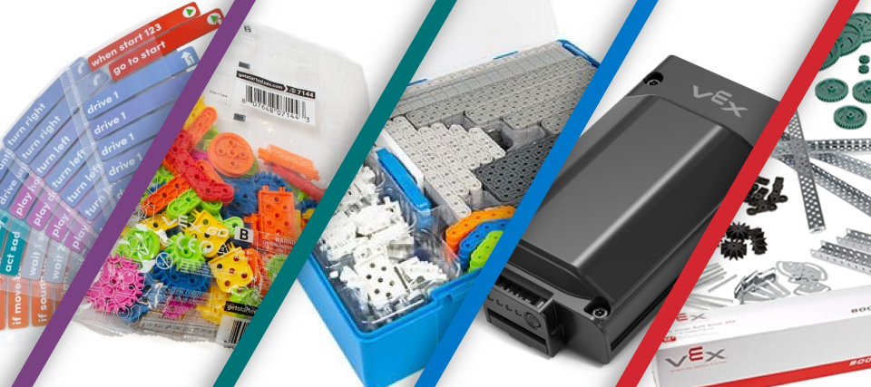

Here are some ideas for what you can look for and order to help replenish your classroom:
- Restock your Coder cards or add another language to your VEX 123 classroom supply.
- VEX GO Parts Packs can help you refill your spare parts bin from the classroom bundles and get extra structure for your students.
- A VEX IQ 1st Generation to 2nd Generation Upgrade Kit provides you with all of the structural and motion components that come in a VEX IQ (2nd gen) Education Kit. This is great for creating your own classroom spare parts inventory.
- The VEX V5 Booster Kit contains over 600 pieces of structural and motion components to help replace missing materials, or for your EXP or V5 students to build bigger and better robots.
